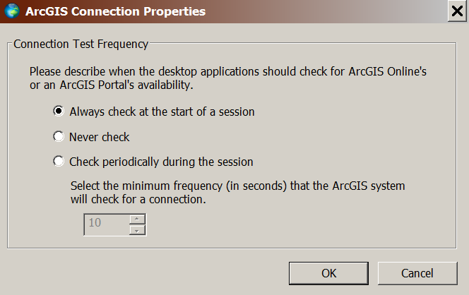

Is this colleague in the same building, on the same network, or are we talking about two people with similar machines at different institutions, or at least on different networks?  What are the individual ping times to ArcGIS Online?  What are the ArcGIS Connection Properties settings on each machine?
Besides the network topology from the client to license manager, which shouldn't be much of an issue with Single-Use licensing, the network topology or performance from the client to ArcGIS Online can make a difference.  The default behavior for ArcMap is to "Always check at the start of a session" for ArcGIS Online or ArcGIS Portal availability.
ArcGIS Connection Properties Dialog Box
We found in our organization that offices with higher latencies to internet gateways were having slower launch times because of the chattiness between the client and ArcGIS Online at start up.  The differences weren't typically earth shattering, but it could be 4+ extra seconds.  If a local office wide-area network (WAN) was really saturated, it could be 8-10 seconds extra.  By changing from always checking to "Never check," most users saw a speed-up in launch times, but that comes with trade-offs because the user has to remember to manually connect to AGOL before loading any new basemaps or other AGOL maps.

Joshua,
Thank your for your help.  The client is gone for a week of vacation. I'll try testing your suggestion if I can find where to go to get to that option of Connection Properties. I don't know of his specific needs to load new basemaps, so I'll have to ask him next week. However, I can test it this week and see if it improves the results.
The colleague is from a different business.  This client is a city administrator. The other works for the county.  I would need you to tell me the IP or domain name to ping for ArcGIS online to get the latency time.  I would not be able to tell you the colleague's connection settings.

Joshua, I have tried changing Connection Properties to Never Check. That brings me to about 16 seconds to start. Initializing License still takes 8 seconds followed by Initializing Application and Loading Document, each of which takes about 4 seconds.
