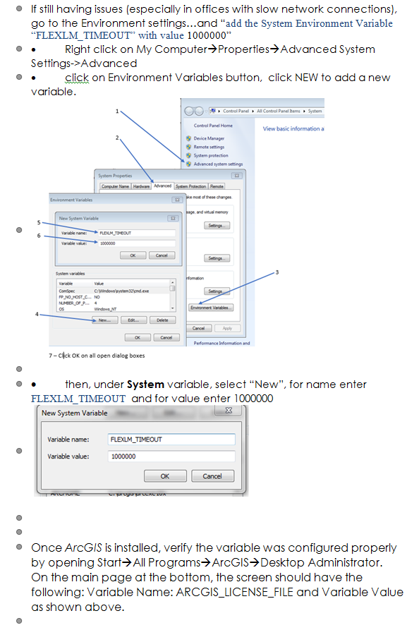

RebeccaStrauch__GISP
MVP Emeritus
are you using a concurrent license?  This has helped in our offices (had to take a snapshot from one of docs...hope you can read it)
If it's a single use license, I'm not sure if that will help or not....but may still be worth a try.

I added the variable and started ArcGIS, but there was no change - still 8 seconds of Initializing License. Do I need to reboot for the variable to be applied in Windows or is it immediate after setting it?  This is a single license.

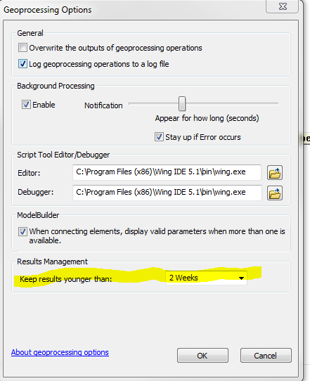

MVP Emeritus
Does he do a lot of geoprocessing and/or run other tools?  Have him open the Results table
  -> Geoprocessing ->Reults
Clean out the results. And then close the software  (ArcMap and/or ArcCatalog)
It might start up faster on reopening.
You can modify how long you want to keep the results in the Geoprocessing Options
I like to keep mine, especially when developing and testing so I can review and/or grab code snippets.  But I do have to clean my Results table often, especially if I've run a lot of tasks that display a lot of comments (again, I use a lot of arcpy.AddMessage lines when testing and debugging).
This is one thing I would try.
