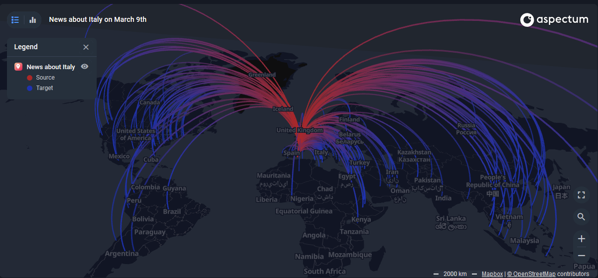

How do you create flight paths (arcs) between two points that look like these?:
To see the live map click or past this following in your browser:
News about Italy on March 9th | Aspectum
We use ArcGIS Pro and ArcGIS Online.
Any suggestions?
Thanks, Todd

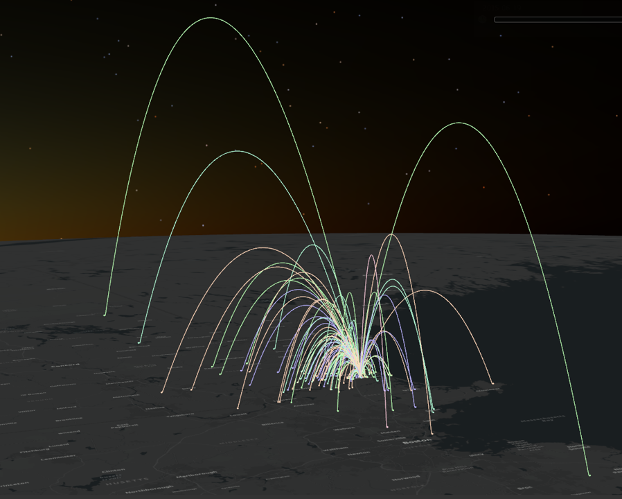

Here's how we eventually created these Arcs:
The link in my original post takes you to the mapping software company Aspectum, which natively allows you to create 3D arcs. These are not 2D line arcs, but elevated 3D lines in an ArcGIS Pro Scene.
I hired Jakub Kmiecik through PeoplePerHour to write a Python script for ArcGIS Pro:
https://www.peopleperhour.com/freelancer/design/jakub-kmiecik-gis-specialist-zxvnzaa
It cost $150. The cost wasn't an issue.
Instead, it would be nice if it were easy to create arcs in ArcGIS Pro.
We wanted to connect each arc from a store location to each customer.
Each arc color represented how the customer heard about us: TV, Magazine, Newspaper Ad, Family, Friend, or Co-Worker.
Our next version will connect each customer to the customer who referred them. This will visually show how word-of-mouth advertising can spread throughout a community.
It will also visually reveal how an ad campaign’s success isn’t determined by the initial customer but also by word-of-mouth after the initial advertising.
