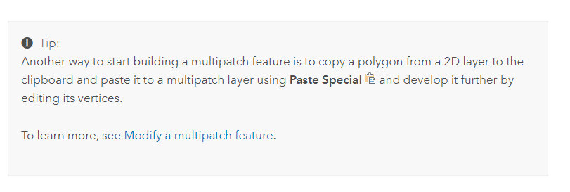

Try copy/paste special.. see this tip in the help:
Create multipatch features—ArcGIS Pro | Documentation

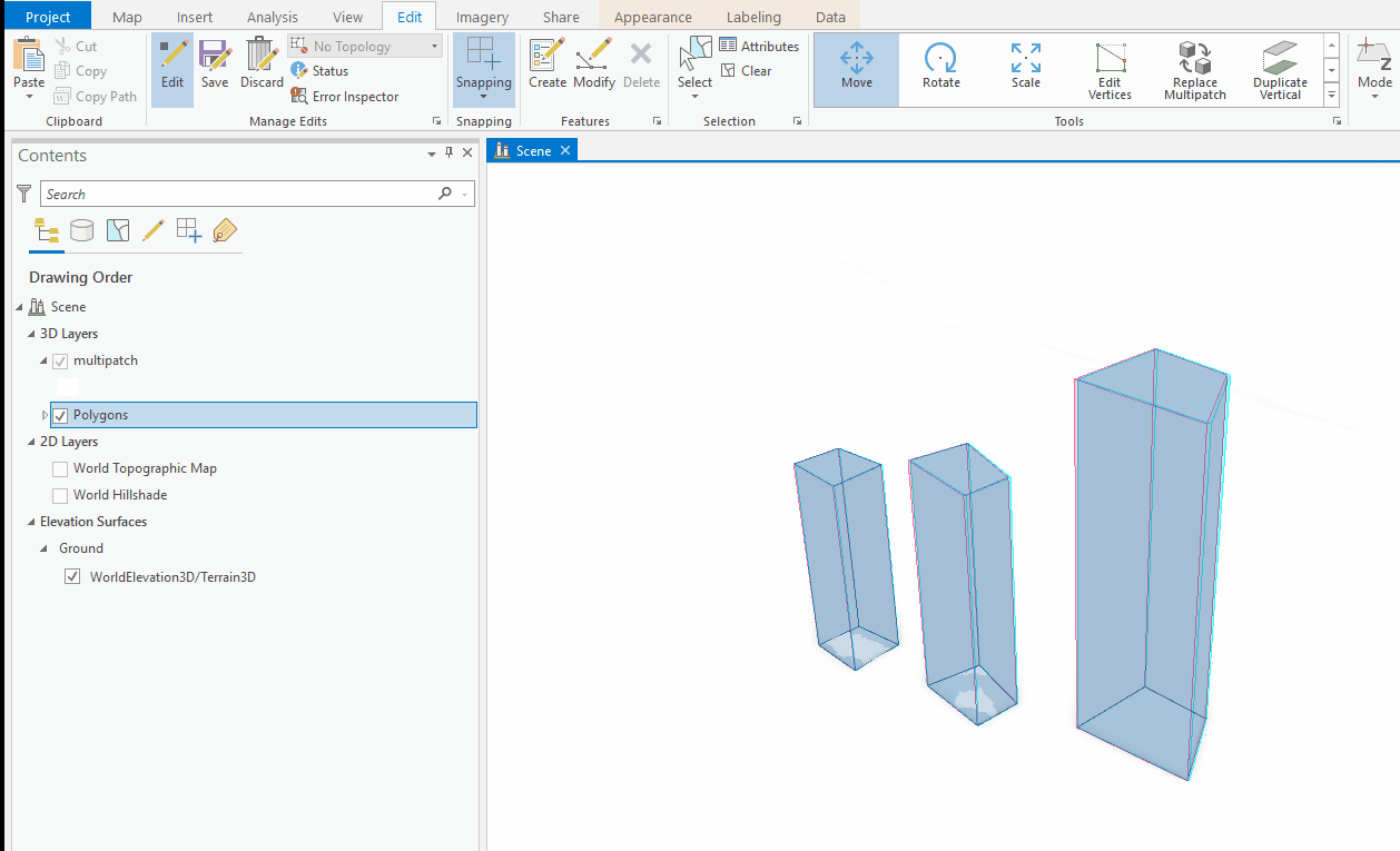

Check out this video of the workflow where I paste extruded polygons to a multipatch layer:

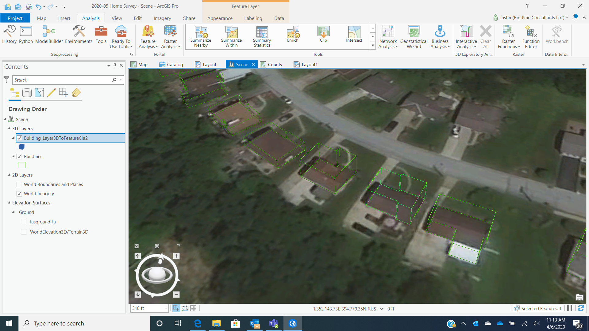

Thank you Scott,  I think we have progress.  After seeing your GIF, I decided to restart my system because no matter what I could not get the drop down arrow to not be grayed out.  After restarting, I followed the above directions.  It pasted and nothing was showing, but after I went into properties of the multipatch and set elevation to "On the ground", they did appear, but not like expected.  Both of my feature classes (the polygon and the multipatch) are in the same coordinate system, NAD 83 PA State Plane US Feet / NAVD88 US Feet, but 2 distinct differences are that 1) the bottom of the multipatch shapes are at a constant elevation rather than "on the ground" like they are in the polygon, so some areas appear floating and others are underground; and 2) the height is somehow redrawn in meters instead of feet so the multipatch features are all shorter than the extruded polygons by a factor of 3.2808.  I have been searching for where meters exist anywhere in my scene and can't find it.
