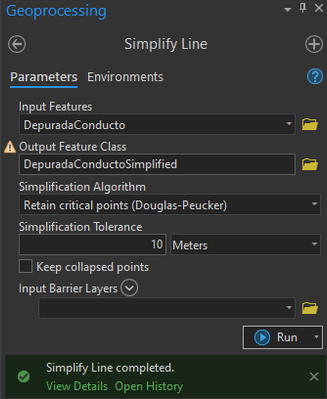

Works in 2.8.3

Hi @JohannesLindner, thank you very much for your quick response.
But I have tried all options: different parameters is not priority, I have moved feature to another gdb, out of dataset and as shapefile.
I have enough disk space and resources.
Using a higher version in my case is not possible; I have tested in Arcgis pro 2.9.2 and ArcMap 10.7.1 and it works in both.
I am interested in making it work in ArcGIS pRO 2.6.3, due to project requirements.
