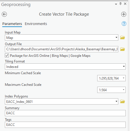

In case it helps, here are my parameters, with the same settings used for all the other areas with no issues.
ArcGIS Pro Version: 2.9.2 with a named user license (Advanced) that is not checked out for offline use.
