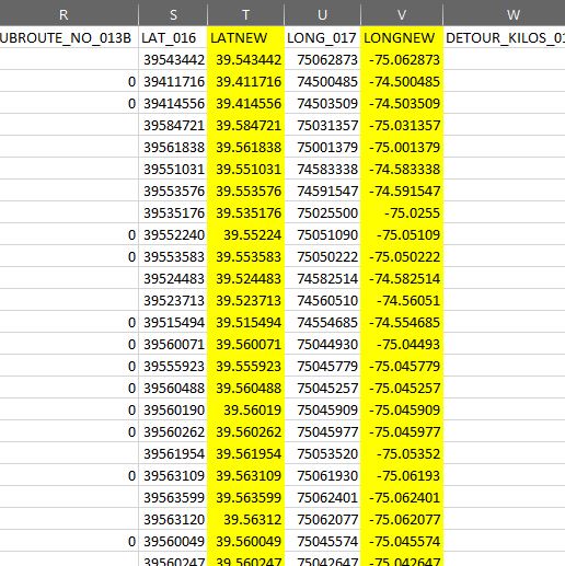

I have a .csv which I am trying to geocode in Pro. The rows I highlighted are the formatted cells. The columns to the left of each highlighted column is the original format.

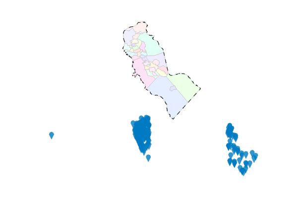

Below is a screenshot of how off the points geocoded.

Columns S and U are strange... are those weirdly formatted lat and longs? Normally if I had values like those I would assume they are decimal degrees and I would need to do a conversion to get them into Lat and Long.

You can see in the screenshot that I did format them - in the highlighted columns. You can see the difference there.

34.XX YY ZZZ  you said the last 0 was dropped off
XX never goes above 59
YY never goes above 59
ZZZ any numbercould just be a strange coincidence but I got thinkin Degrees Decimal minutes 34 59.123
worth a check.

That's great to know, thank you. I'm unfamiliar with the breakdown of the format so this is good information. I just did a quick scroll and confirmed that the XX and YY numbers do not go above 59. The points are anywhere between 7 and 20 miles off of where they should be.

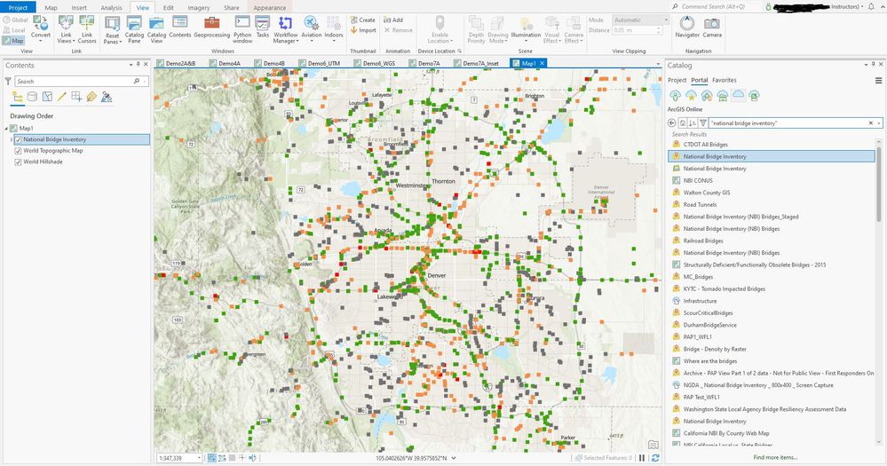

Unrelated to the positional error but you can add the National Bridge Inventory from ArcGIS Online to your ArcGIS Pro project by going to the Catalog Pane->click the cloud>search for National Bridge Inventory and add it as a web layer to your map.  See graphic below.
