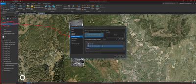

1) Are you sure your Layer Properties are set to the same as the Utility Map  for example the coordinate system ? Here is an example :
This is really important when you export or save as new georeferenced image.
2) Second, when you export your new georeferenced image, it should add it to your map and then it should overlay your  not georeferenced image ?
3) if both 1) and  2) works, then when you export to PDF, what do you see it when you open the PDF ?
If you open it and if the image shows up on your PDF then it should work...

I was using the Set SRS button in the Georeference tab to set the coordinate system.
After reading your post, I tried it again with a new image. I used the Define Projection Tool to set the coordinate system, before opening the Georeference tab, and that seemed to work!
It's weird, because it was showing up in my Layout before, but not showing up in the exported .pdfs.
Defining the projection using the Define Projection Tool first has me on my way!
