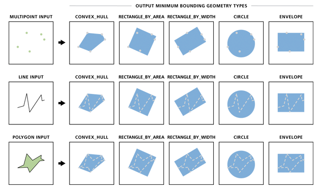

  7. Use the Minimum Bounding Geometry tool to create convex hull polygons from your buffered multi-part/dissolved point polygons.

Why do you want convex hulls? Why not a minimum bounding circle? A minimum bounding circle might eliminate the need for the buffered points step.
https://pro.arcgis.com/en/pro-app/latest/tool-reference/data-management/minimum-bounding-geometry.ht...
Or, better still, could you generate a circle using the longest cardinal direction measurement, using the point geometry as the middle of the circle? (Maybe using a simple technique like the Buffer tool.)
