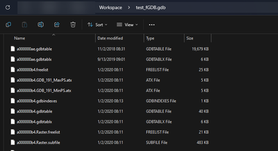

it looks like they sent you something that is not complete. The ".gdb" file is usually a folder (the file geodatabase) that contains all the files you need.
Maybe have the person send you a zip file of the entire .gdb folder. Here is an example of what may be in the .gdb folder:
