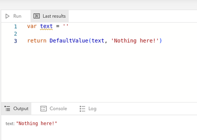

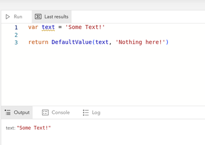

There's also DefaultValue, which was made for this very thing. If there's a value, it returns, otherwise it falls back to the value you specify.
- Josh Carlson
