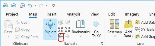

Sehouse
You can simply click this button here:
