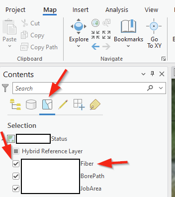

If your project was up all night, it could have lost its connection to the SDE or a FGDB, you may have to save the project and restart it to get it working. Other than that, ensure that the layer is selectable here:
If there are any unchecked, you will not be able to select the layer. This is in the Contents pane under "List By Selection".

This I al ready tried but everything is selected with a filled box like the one you have with Hybrid reference layer.
