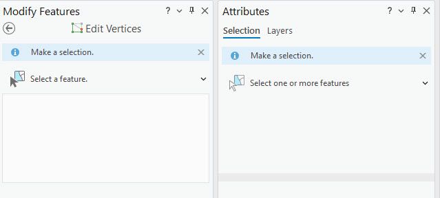

There are zero selected features on the map and you open the Edit Vertices tool from the Edit tools gallery or Modify Features pane.  On tool open, the active select tool is active and the tool name is ‘Select a feature’.  You interact with the map to select a valid feature. Once a single selectable and editable feature is selected, the Edit Vertices tool is active.
This is a key point; you do not need to use the core Select tool before choosing the edit tool or even once the tool is open.  Choose the editing tool, and then the pane will guide you through the rest, eliminating clicks between tabs and panes.
Alternatively, when the active select tool is active, a selection can be made via the attribute table or other methods and the Edit Vertices tool will activate.
Screenshot showing the  Edit Vertices tool without a selection.

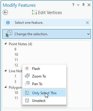

There is more than one valid selected feature on the map and you open the tool.  On tool open, the active select tool is active with the tool name ‘Change the selection’.  You can interact with the map to update the selection or clear features from the selection set from the tree node or update the selection in the attribute table.  Once the selection is reduced to one valid feature, the Edit Vertices tool will be active.
EV_Treenode.jpgScreenshot showing the tree node context menu for managing feature selections.

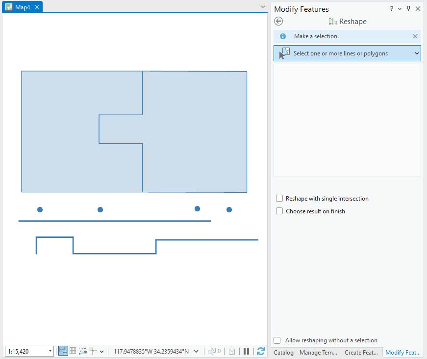

There are zero selected features on the map and you open the Reshape tool from the Edit tools gallery or Modify Features pane.  On tool open, the active select tool is active with the tool name ‘Select one or more lines or polygons’.  You interact with the map to select one or more editable line and/or polygon features.  Once selectable and editable features are selected, the Reshape tool is active.
Same as above, you do not need to use the core Select tool before choosing the edit tool or even once the tool is open. If you switch to the core Select tool, the edit tool will not automatically activate when there is a valid selection.
Reshape_SelectOneorMore.jpgScreenshot showing Reshape tool without a selection.

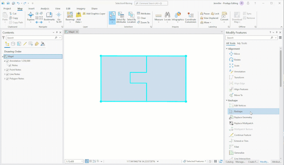

There is one or more valid selected features on the map and you open the tool.  On tool open, the Reshape tool is active. The active select tool name is ‘Change the selection’ indicating it can be used to interactively redo the selection on the map or filter any external selections.
Reshape_ChangeTheSelection.jpgScreenshot showing Reshape tool with a valid selection.

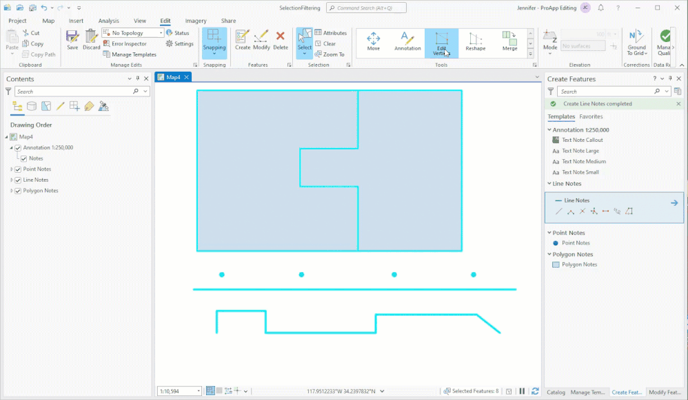

There is a mixture of valid and invalid features selected and the user opens the tool.  On tool open, the invalid selection is filtered (or cleared from the selection) and the Reshape tool will activate. Whenever a tool filters a selection, there will be a toast notification.
Selection filtering may be more apparent with Reshape than Edit Vertices since it will only select lines and polygons.
You can choose to reactivate the active select tool at any time while the tool is open to update the selection on the map or filter external selections, e.g. point features were added to the selection using Select by Location.
How about the scenario of adding to a valid selection?  You can add to the selection before or during the sketch by holding the shift key and clicking the feature to add to the selection.    Conversely, features can be removed from the selection before or during the sketch via the tree node feature identifier’s context menu.  Adding to and removing from the selection set is available for edit tools that support one or more selected feature.
Gif showing Reshape active select tool interactively selecting and filtering features.
