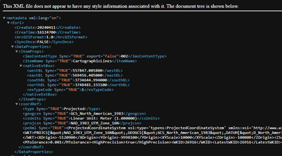

Any update to this? Still marked as 'in product plan' and the spatial reference information is missing from exported metadata, so I either get warned by the USGS metadata validation service (mp 2.9.52) for missing spatial reference information. Or I use Save As in ArcPro to an XML, and it throws hundreds of errors when using the validation service because it doesn't save in FGDC format. Marking this problem as solved and that one of the solutions is to use the Save As function in the Catalog view is not really a solution.
Format when I Save as
vs. when exported as an XML
