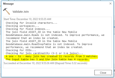

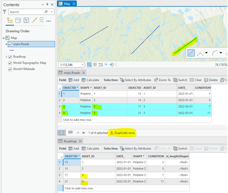

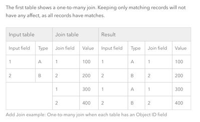

It looks like the Add Join (Data Management) geoprocessing tool might do what I want:
Related:
Test:
Before:
  • No join
  • Three features
After:
  • Joined to a table that has duplicates. The join is based on the common ASSET_ID.
  • Now, there are 4 features. ASSET_ID #3 has been duplicated, since the related table has duplicate rows for that asset.
