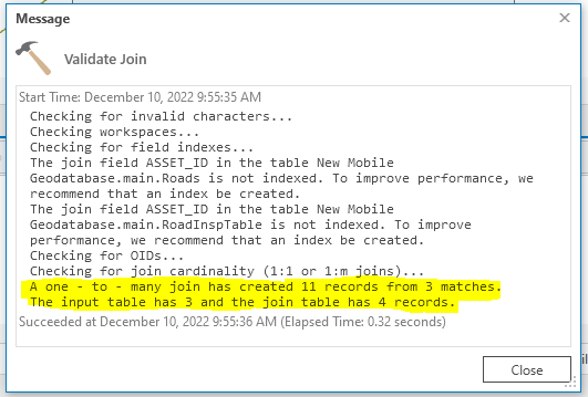

@mpboyle I think ArcGIS Pro 3.0.3 already does what you want. Adding a join can create a 1:M join.
Before:
  • No join
  • Three features
After:
  • Joined to a table that has duplicates. The join is based on the common ASSET_ID.
  • Now, there are 4 features. ASSET_ID #3 has been duplicated, since the related table has duplicate rows for that asset.
Make sure both FCs/tables have ObjectIDs and are in the same geodatabase.

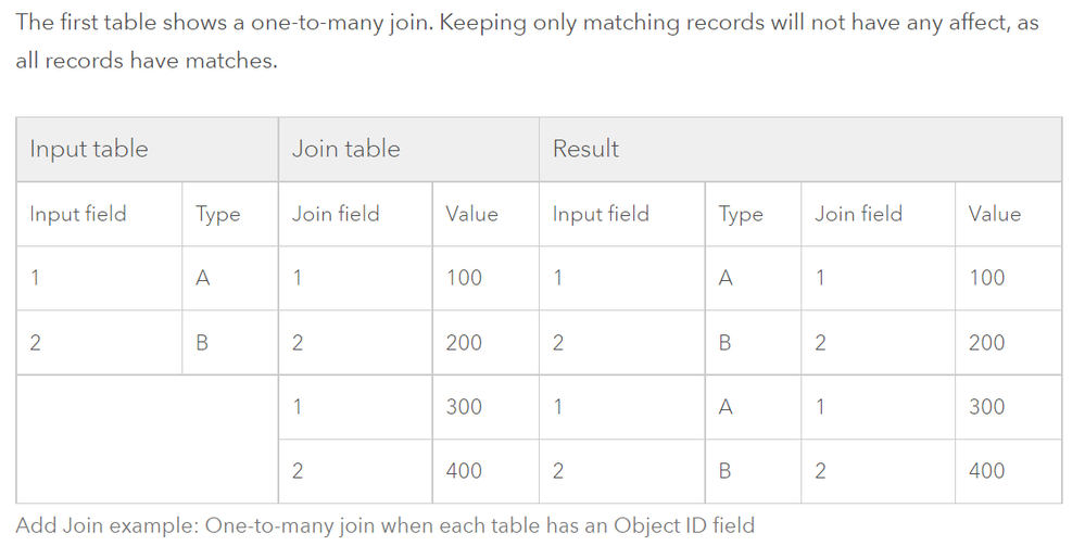

Summary of the doc:
Add Join does support one-to-many when the following two conditions are met:
  1. The dataType must have objectIds
  2. The data must be within the same workspace.  (Shape files are excluded)
Details on why:
The internal tool IRelQueryTable has two modes for Joining data together:
  1. Client side - A one-to-first join is done, which matches ArcMap.
    First is determined by how the data format is read, which is usually ordered by objectId or record order in text base data.  Client side joins are used when both conditions of a one-to-many are not met.
  2. Server Side -  The workspace manages the join, so in these cases our File Geodatabase (Or other databases) will do the one-to-many join.
