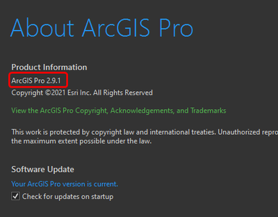

  1. What version of ArcGIS Pro you running? The current version is 2.9.1.

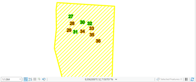

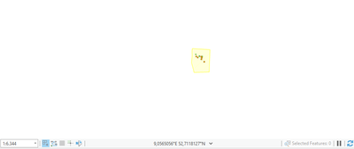

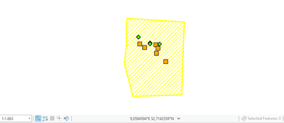

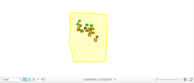

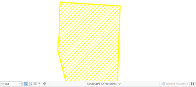

I just started having the same issue. Wasn't a problem before, but suddenly features and labels appear and disappear as if a visibility range was set. I was looking at the same data yesterday and it didn't happen...
I am using ArcGIS Pro 2.8.3. The data is stored in file gdb. Haven't tried repair geometry (does this do anything to point data?) and the fc to fc tool yet.
IlkaIllers1
IlkaIllers1_1-1643109705104.pngIlkaIllers1_2-1643109725797.pngIlkaIllers1_3-1643109758562.png
All I did was zoom in and out. It stopped loading but features and labels appear and disappear randomly.
shan_sarkar
Upgrading to the latest version of ArcGIS Pro is usually a good move as they resolve and implement a lot of Bugs and enhancements for the older versions.
