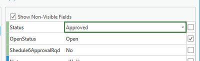

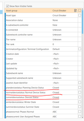

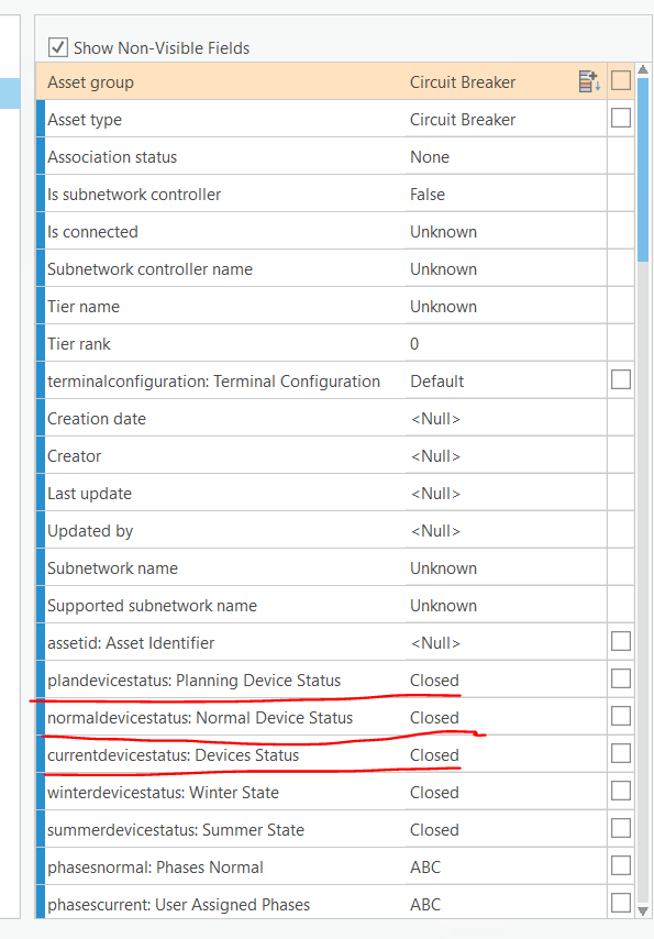

We are working with the utility network and are having trouble keeping feature templates to hold between the map we are publishing from and the feature layer/service. We have feature templates created for all the layers in our initial map based on subtypes. When we publish the feature service and bring that back into ArcGIS Pro some of the templates are not holding their default values. See below.
Below is the feature template for the layer Electric Device in the initial map we publish to our portal from, the defaults are holding.

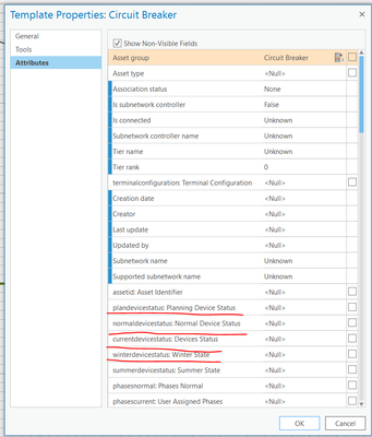

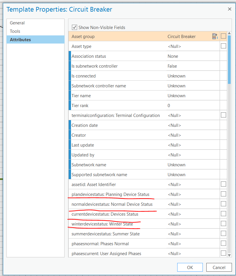

After publishing the service we bring the feature layer Electric Device back into a new map in ArcGIS Pro and some of the defaults in the feature template are no longer holding.  See the image of the template below.
If we delete all templates on the feature service layer in ArcGIS Pro and re-create the templates the defaults come back. But this should not be something we have to do for each layer every time we might need to change something. Has anyone run across this issue and have any suggestions to solutions?
