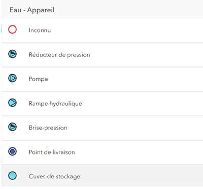

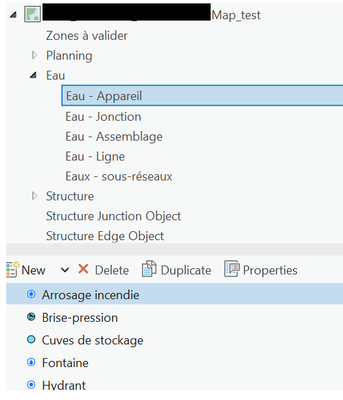

I see the following;
In ArcGIS Pro the templates are there for the web map.
I go and check in the map viewer
I see that the templates are there

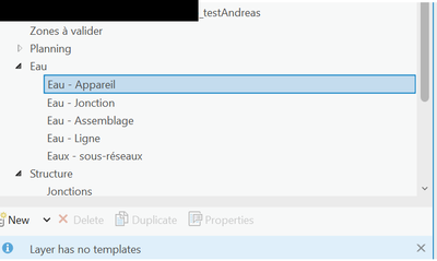

Yet when I add this published web map to my arcgis pro I get the following result.
I could be related to the bug, but it still seems a bit different?
Scott_Harris
Yes, that seems different. There could be many factors involved so please reach out to Esri Technical Support so they can help narrow it down and log a new bug if needed.
