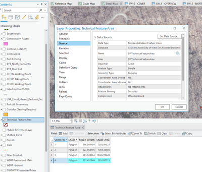

I have this same issue and it is so frustrating!!!  My issue is with 4 simple polygons in a File GDB Feature Class - I zoom in and out and they just randomly disappear.
I wish I understood what "scale default limitation at certain scale levers that small." means. I thought maybe it has something to do with the polygons having a hatched fill...but i just cannot figure anything else out.
WDMParkPlanner
Worth noting: I figured out to "repair geometry" and that did the trick for me...sorry that it did not for you!  Here is what I got from the repair geometry process:
