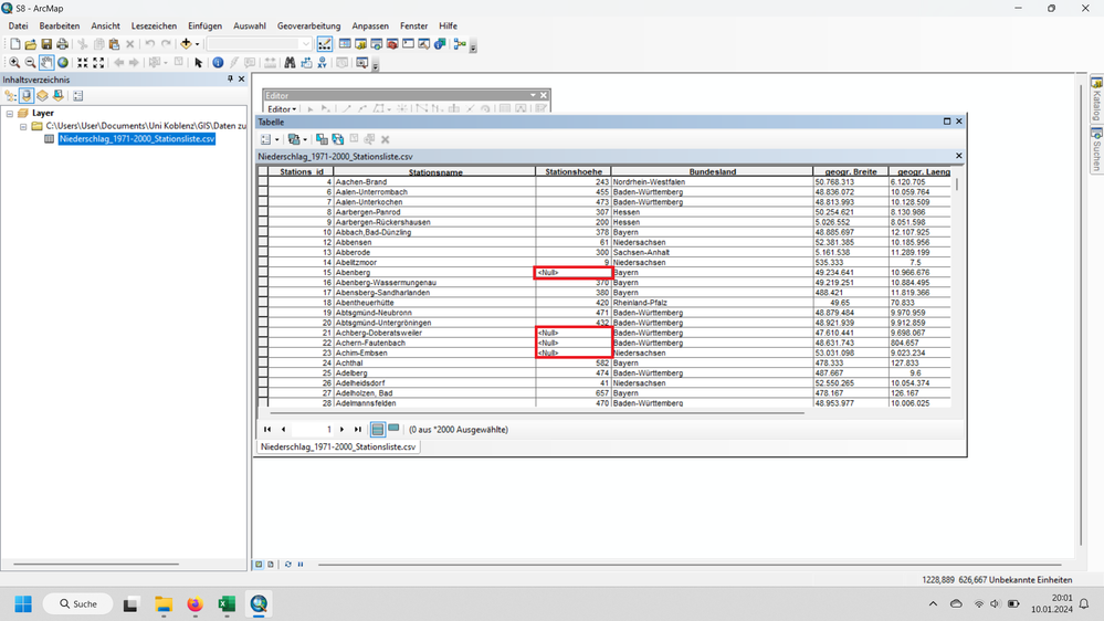

Hello everyone, I`m using ArcGis 10.7 and i have a problem with NULL-Values in a attribute table.

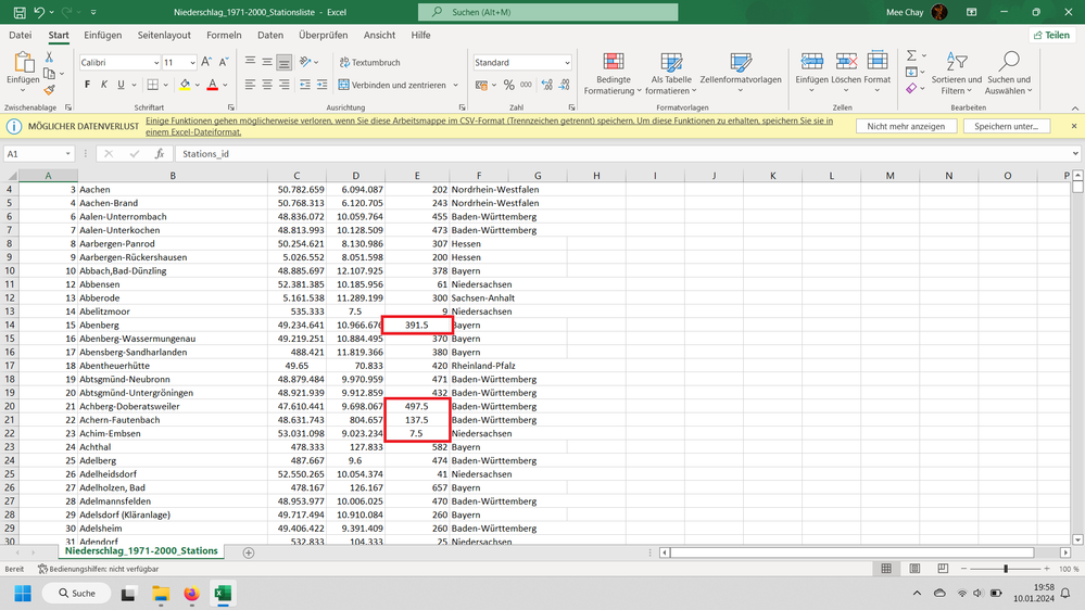

I downloaded a .txt file from the Inet, imported it to Excel and saved it into a .csv to work with it in ArcGis.
I noticed after I opened again the .csv in Excel that Values which weren`t adjusted correctly in the cell (for example they were placed in the middle of an Excel-cell instead at the right) had a NULL-Value in the Attribute table in ArcGIS.
I tried to fix this in EXCEL but my adjustment weren`t safed. I can`t change the formation of the cells! Maybe because it`s originally a .txt file.

Can you please share some screen shots of the data in Excel and how it appears in ArcMap? I would also maybe try saving the csv as an xls file and import it to ArcMap and see if that works.

Thanks for the answer. Here are the screenshots.
