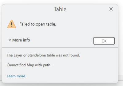

This happened to me for the first time today. Got both "Failed to open map view" and "Failed to open table" (I had a table open with the map when the project was last saved). I deleted one of the 2 maps shown under Maps in the Catalog window - it pointed to a service and I thought that could be causing an issue. Saved the map. Now it opens without the errors, but the map window is still closed and if I try to open it I get the "Failed to open map view" pop-up.  If I select "Update data sources" from the map context menu, the full list of datasets I had in the map window is shown. I exported the list so I can rebuild the project later, but it was a large project - aargh!
Nearly all datasets that were in the map are on my local external hard drive or our office NAS drive. Data from these sources are behaving normally in another project I am working in. Three datasets are National Park Service service layers from sites that I checked are still live. Nothing is accessing One Drive. Aprx file was ~2.3 Mb.
Running 3.5.6
Not using classify or doing any raster processing last time the project was open, which was late May. A field calculation was the last operation according to the history tab. None of the suggested fixes worked. The copy on my backup drive was also corrupt.
