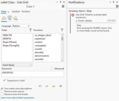

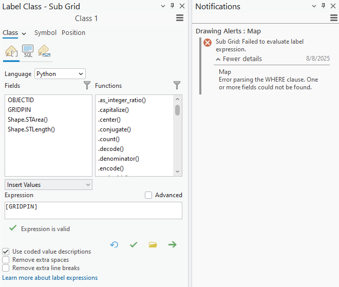

I can't quite wrap my head around this one. I have a project that was created with ArcGIS Pro 2.9. I have upgraded it to 3.5. I have a polygon layer ('Sub Grid') that is set to show labels using the value in a field, 'GRIDPIN'. That's it. Although the labels are showing up exactly as expected in the map, I am getting a drawing alert.
You can see the field 'GRIDPIN' listed in the Fields section of the Class tab. It definitely exists.

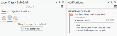

There is no SQL expression set on the label class. There is no definition query on the layer.

So a couple things I'm seeing that are related to your experience:
1.  If you switch the language from Python to Arcade, does the error message persist?  The expression would be $feature.GRIDPIN
2.  There is BUG-000164308 - "The drawing error, "Failed to evaluate label expression. Error parsing the WHERE clause. One or more fields could not be found." is returned after adding a label expression that uses Shape.STLength() in the WHERE clause."  Not exactly related but close.  It was non-reproducible and first noticed in ArcGIS Pro 3.2 due to the introduction of Drawing Alerts.  Are you using a file or enterprise geodatabase in this case?

The issue seems to persist no matter what language the label expression is written in. The data is being sourced from a local file geodatabase.

Interesting.  Okay, try this.  In a new ArcGIS Pro project  use the new default file geodatabase, copy/paste the FC to the default fGDB, label the FC using any expression language you want and see if the error message persists.  If it does not, then there's an issue with the original FC.  You can use the Repair Geometry GP tool to see if there's an issue with the original FC too.
KristyCline
Great suggestions! I copied the feature class over to the new default geodatabase created as part of a new project, and labeling worked fine there. Unfortunately, repairing the geometry of the original feature class did not resolve the labeling issue. I ended up removing the layer, re-adding it, and re-setting symbology and labeling properties for all maps using that layer, and that seemed to resolve the issue. Funny how feature classes can sort of decay in a project if you leave them be long enough. 🤔
