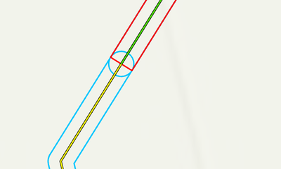

The red flat end buffer is ignoring the yellow line, claiming it's too short and throwing up a warning. The line is 1.5 miles long. And the SHAPE_LENGTH field knows it. I've tried at least ten times. I've exported it and tried to buffer it all by itself, same deal. I created a new empty feature class and appended the lines into it. This line absolutely will not be buffered. When I buffer with rounded ends, I get no errors, and this (yellow) line is buffered. I just upgraded to 3.5. Is this a bug in 3.5?

Thanks. The first thing I tried was repair geometry. Didn't work. I made a new empty feature class and appended features in. Exported the single line. None of that worked. The repair geometry tool did not report any errors and the shape_length of the segment accurately reflected it's length.
RandyMcGregor_BMcD
Graphic buffer with butt end works. I think the regular buffer tool is having a problem with flat ends.

Regular buffer tool. Pairwise version has no 'flat' end option. I did have luck with 'graphic buffer.' I think there is an issue with the regular buffer flat end option.

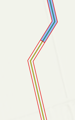

curious.  The feature looks simple enough, but I wonder if there are extraneous/unnecessary vertices along the latter portion of the bend in your image since the error suggests the process may be working on segments (... claiming it's too short ...).  You might want to check this if any are found give simplification a try
