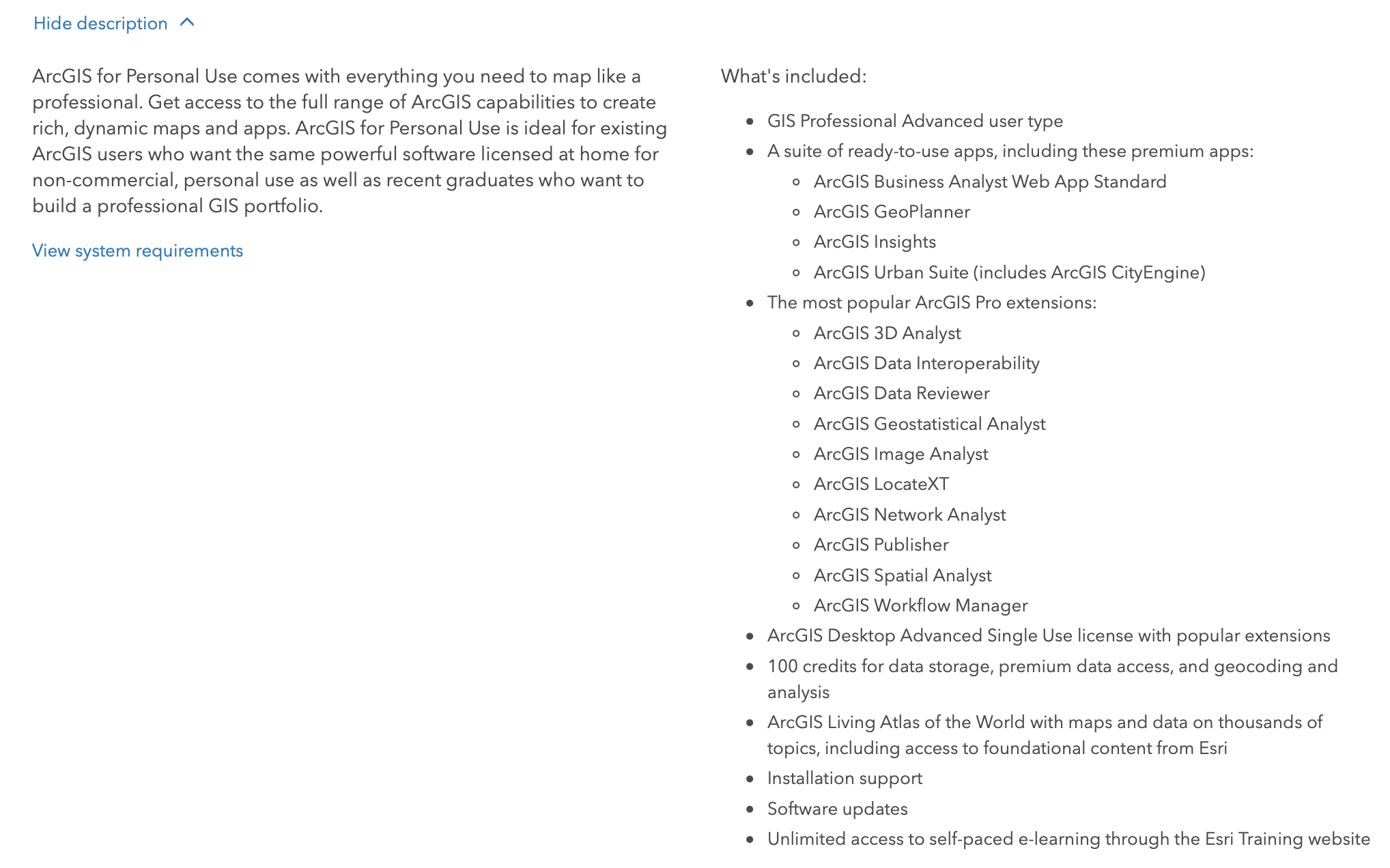

Hi I'm trying to run ESRI's ProPat performance testing benchmark tools using a personal license of ArcGIS Pro.  My interpretation of the marketing page was that extensions are included with the license:
However when I authorize Pro using my personal use account extensions are not available
Can someone clarify if this is supposed to be a thing?
