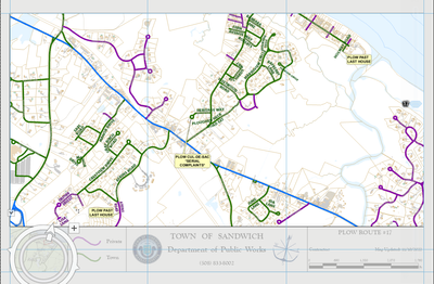

Hi, I'm combining multiple snow plow route maps into a single project, using a Map Series and the Range functionality.  The range is based on a number field, and controls the street centerline line features and point features for route-specific notes.
Please see attachment.  The street segments on the route are labeled based on the symbology.  Streets not on the route have a more subtle, grey label.  In these maps, that was achieved by opposite definition queries.  In my new project, I have done my best to set up the grey labels so they are low priority and directly on top of the line.  This works well enough, keeping them out of the way of the more important labels of streets on the route, but ideally the grey labels would only be for streets not on the current route.

This is a tangent, but speaking of that process, I consistently run into an issue where, upon activating the map frame that already has a range applied to it, everything looks as it should:
However, as soon as I pan or change the rotation, all features are shown, but the range is still applied:
Upon closing the map frame, all features are still shown.  Usually, switching to another Map Series page and then back again solves this, but not always; sometimes I have to reopen the project.  This seems to just be a visual bug, as exporting the page only shows the features with that range value, as intended.  Have you experienced this?  I know it's not directly related to the original question, and like I said, it doesn't seem to actually mess up the range, so I don't think it affects me enough to post a separate question for it, but I am curious if you've seen that behavior.

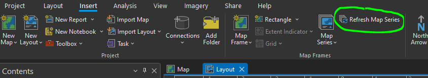

TomBole
Hi Josh,
I have run into issues where the map series page is "out of sync" and is displaying the map in unexpected ways. I don't think I've run into the exact scenario you describe, but I'm not really surprised.
When you activate the map frame you are changing the application context from Layout to Map - as you can see in the ribbon. The map frame becomes a "mini map view". Changing these context after making changes in one or both of the contexts can result in some issues.
We consider this behavior a bug and would like to fix this. If you can please contact Esri Support. They are better equipped to handle troubleshooting steps and gather bug data. They can be contacted at https://support.esri.com/en/contact-tech-support.
The good news is this synchronization problem can usually be rectified by refreshing the map series. You've seen this by changing the current map series page. You can also refresh the entire map series.
Closing the project and reopening is a last resort and hopefully something you do not have to do to often and hopefully not at all.
Thanks for the feedback!
