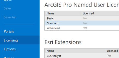

you should see a full list of those installed and licensed (after 3D Analyst of course)

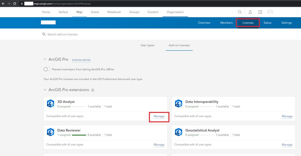

Here's what I did:
Go to ArcGIS Online >> Licenses tab:
https://  <your user name>   .maps.arcgis.com/home/organization.html?#licenses
Click Manage in the extension you want to enable.

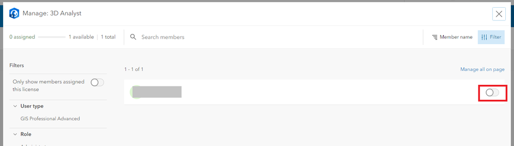

Click the toggle in the extension popup to enable that extension:

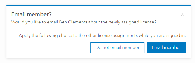

Choose yes or no to the email question:

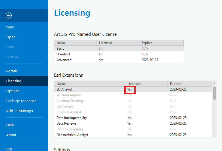

Close and reopen ArcGIS Pro.
Now, the extension is enabled in ArcGIS Pro for Personal Use (3.0.2).
