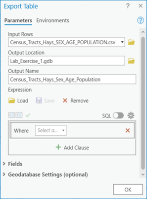

I am attempting to export a CSV Text Stanadlone Table into my Geodatabase; thereby converting it to a File Geodatabase Table.
However, as you can see from below, I do not see the 'Output Location' option where I would specify my GDB..?

OK, so they've gotten rid of the Output Location input box in 3.0 (see below from 2.9) -- and just built it an the Output Name into one Output Table box. ...

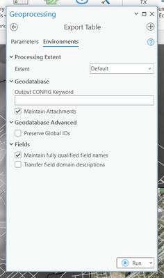

If I click on that tool's Environments, this is what I see:
Craig_Eissler_Iceman
OK so I found that Geoprocessing Option, but no sure what that has to do with the 'Output Location' input option that is no longer in the tool, as far as I can tell..? Or, is there some other Setting that controls that.
