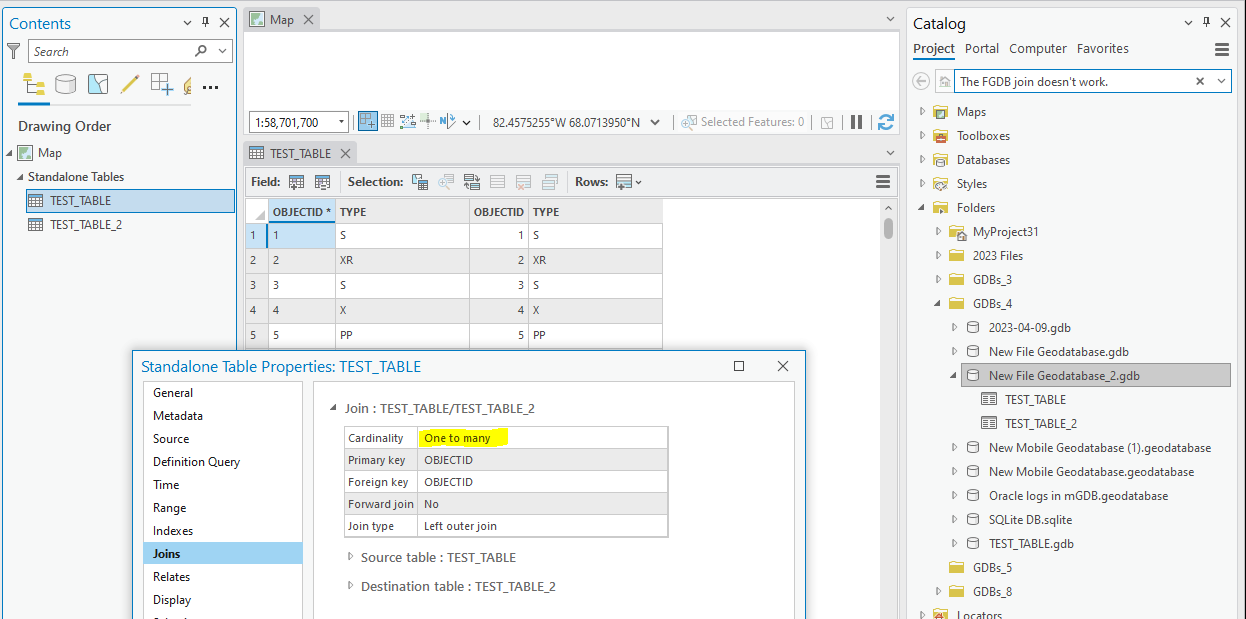

I have a table in a FGDB called TEST_TABLE. I've copy/pasted the table via Catalog into the same FGDB as TEST_TABLE_2.
I've added both tables to the map. In the attribute table of TEST_TABLE, I create a join to TEST_TABLE_2 via the OBJECTID columns.
With TEST_TABLE, I open Contents —> right-click —> Properties —> Joins. The join is shown as one-to-many. But it's actually a one-to-one join -- because the tables being exact copies and the fact that OBJECTIDs don't allow duplicate IDs.
Why is the join shown as one-to-many if it is one-to-one?
Video:
Note:
I used the simple case above to demonstrate the issue. But my real use case is creating a database view on TEST_TABLE and joining from TEST_TABLE to the view.
select objectid, case when type = 'NT' then 1 else 0 end as flag from test_table
The same issue happens with the joined view: the join is shown as one-to-many but it is actually one-to-one.

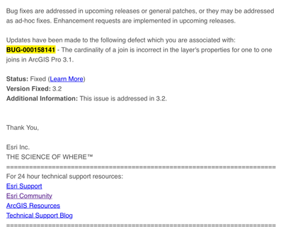

This is the latest email update I received about that bug:
2023-07-26
It says the issue is fixed in 3.2.

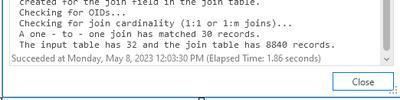

I just that that was one of the 'updates' with Pro 🙂
Even using the Add Join tool:
Then look at the results of that join:

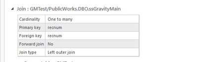

Gene_Sipes
Did this bug get squashed? I am seeing the same issue in arcgis pro 3.1.2 except the cardinality is shown as one to one in the relate properties, but it is clearly a one to many in fucntion.
2023-07-26
