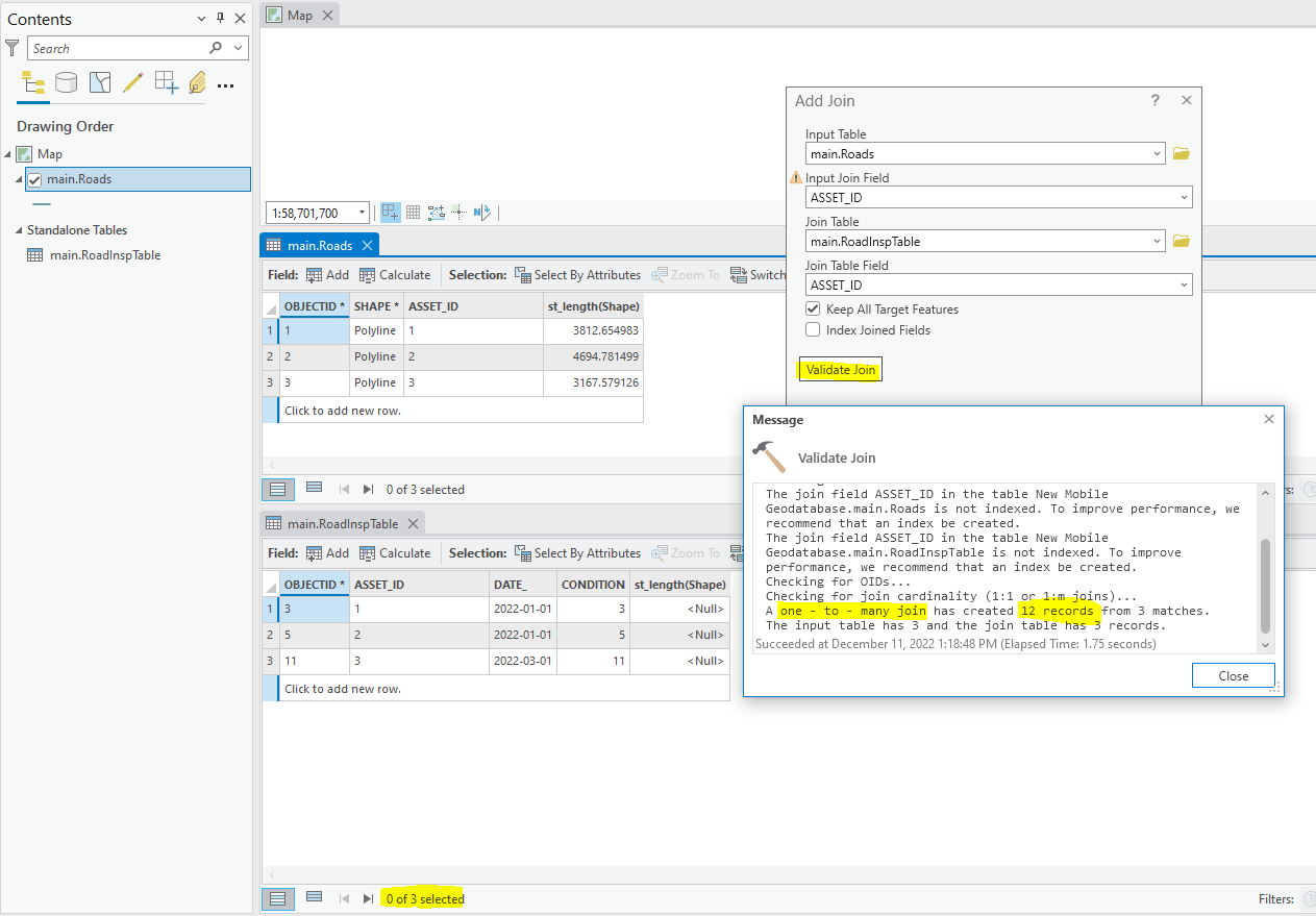

I'm in the process of creating a join from a FC to a table that has a definition query (the table has 12 rows, but the definition query pares it down to 3 rows).
When I hit the Validate Join button, I get these results in the Message window:
Checking for join cardinality (1:1 or 1:m joins)...
A one - to - many join has created 12 records from 3 matches.
The input table has 3 and the join table has 3 records.
I don't think that information is correct. The join is 1:1 and it will result in 3 records in the source FC (same as before the join). But the Validate Join message says differently.
Is that a known issue?
Thanks.
ArcGIS Pro 3.0.3; mobile geodatabase.

Esri Canada Case 03262451 - Validate Join message has incorrect information (join to table with definition query)
BUG-000156405  - Validate Join message is incorrect in ArcGIS Pro when Add Join to table or feature with Definition Query within the same workspace

BUG-000158141 - The cardinality of a join is incorrect in the layer's properties for one to one joins in ArcGIS Pro 3.1.
Additional Information: Will doc this better and see if there is something I can do with the MapAuthoring team. All the joins in Pro are have Cardinallity 1 to many, so saying so does not give value to users. Our messages in validate join are correct.
One-to-one join is shown as one-to-many
