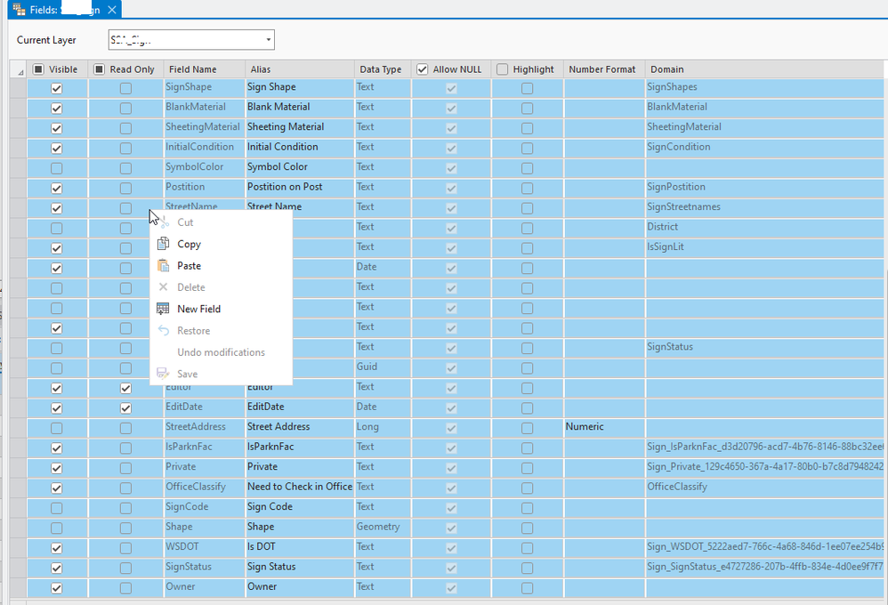

Hello  everyone,
Could I export the "field view"  or "field properties " information in a new table as a excel sheet from attribute table ?
I am not sure if it is possible or not, but I need the information such as "field type, field length, default details, etc..
I will upload one capture so it will be clear more for you guys !
This information what I want to export
Thanks

If you highlight each row you can copy and paste into a blank excel spreadsheet if that's what you're after.
I could probably find a python solution to automate it but that may be overkill depending on your use case.
RhettZufelt
MVP Notable Contributor
Just select the top row, scroll to the bottom, hold shift while selecting the bottom row.
This will select all rows, then you can right-click copy, open Excel and paste the entire table into Excel.

FYI General Schema Report gives exactly what OP was looking for - on the "Field" tab. Copy/paste from ArcGIS Pro did not work for me (AGP 3.2.2; current version of Excel - tried both desktop and M365 web).
