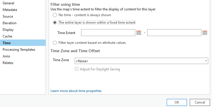

with ArcPro 3.1 there is the ability to enable Time on raster layers. This python modules dont have an option to input the start and end time for a raster file, it only allows you to set the field, which raster files do not have. How can I use python to enable the time property on a raster layer, and set the start and end times without having to go into ArcPro and manually set them?
I want to be able to do something like:
map.listLayers(l)[0].enableTime('Date','Date2') in python so I can batch process hundreds of raster files and add them to a project so the Time is set.  This works for a shapefile that has an attribute table, because I can create a field with the start and end date and add them.  But I want to be able to do this for a raster.

I finally managed to enable time on raster layers by setting the layers attributes via the CIM:
import datetime
p = arcpy.mp.ArcGISProject("CURRENT")
m = p.activeMap
for l in m.listLayers():
    if l.isRasterLayer:
        l_cim = l.getDefinition('V3')
        l_cim.useVisibilityTimeExtent = True
        time_extent = arcpy.cim.CIMExternal.TimeExtent()
        layer_date = datetime.datetime(YYYY, M, DD, tzinfo=datetime.timezone.utc) # replace YYYY, M, DD with the date of the raster-layer
        time_extent.start = layer_date
        time_extent.end = layer_date
        l_cim.visibilityTimeExtent = time_extent
        l.setDefinition(l_cim)
