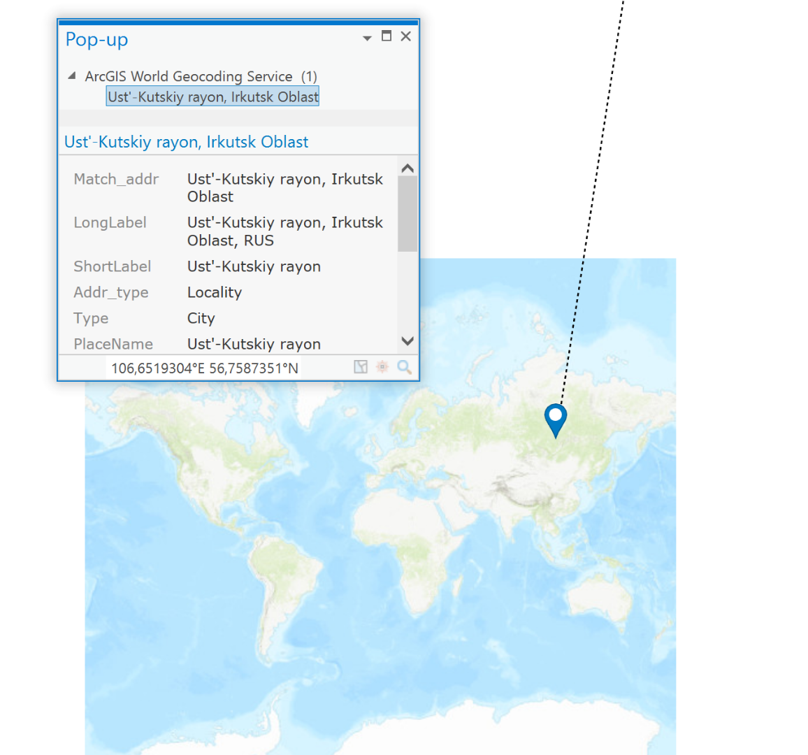

Recently I've had some problems with left clicking on the map after geocoding a table, using the ArcGIS World Geocoding Service. When I left click on a map or on a feature, no blue circles appear and no popup appears, basically nothing happens. After uninstalling the latest version of ArcGIS Pro (2.3) and installing 2.2.1 again yesterday I got rid of the problem. But after geocoding again today, I got the same problem. Updating to version 2.3 didn't fix the problem. Another thing that I noticed that if I now randomly right click on a map and click 'what is here' it pulls a random line to the top right of the screen, which goes on endlessly (which isn't the biggest problem but maybe related?).

The issue with the "What's Here?" right-click function is certainly odd as well. Introduced in 2.3, this now shows a dotted line connecting where you right-clicked on the map, and where the address is actually located in the real world. Clearly its not expected the real life feature is off the map like in your screenshot. Can you reproduce this when using the "What's Here?" function in other parts of the world as well?

Concerning the "What's Here?" function. While using this function, all
addresses over the world showed a line going to the right side of the
screen. But they didn't all go to the same point, some lines were almost
going straight up while others were more going to the right.
