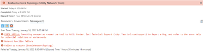

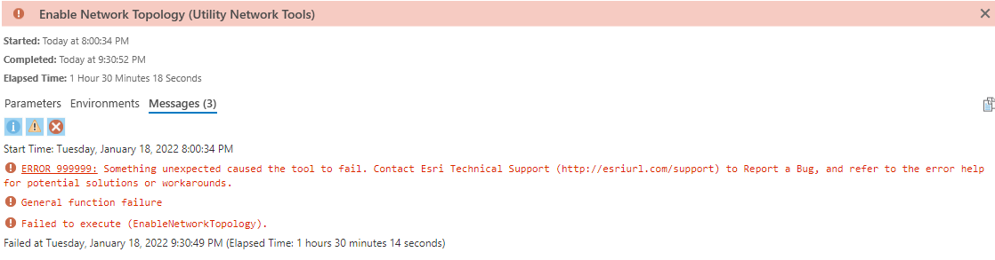

I am using SQL Server to host the enterprise geodatabase. At first we thought it was a resource problem so we scaled up the database and VM used to publish the feature services. Unfortunately, that did not resolve the problem. This customer-supplied asset package is the biggest I have ever worked with before containing over 20 million features in their electric utility network. The geoprocess hangs at 2% and then fails like clockwork around 1 1/2 hours.

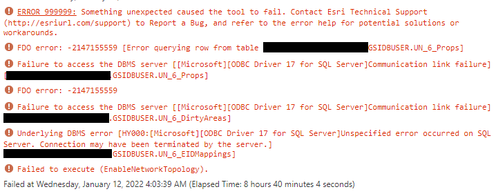

I've tried to also run this process on my personal computer in the past in which I received a different set of errors after the process ran for 8 1/2 hours.
This set of errors could be caused being I'm using my personal computer on not the most stable of networks. However, I would get the same set of errors around the 8 1/2 hour mark on each attempt.
I then went back to the VM we used for publishing as it is hosted at the same data center as our database. This is where I'm stuck with the "General Function Failure" error message that gives me no insight as to what is wrong. Any insight is greatly appreciated!

In regards to the "Generic function failure" error messaging, the issue was due to not having enough storage space on my hard drive. The "Enable Network Topology" geoprocessing tool created 90gb in temporary log files due to how large my dataset was.
I have not been able to fix the second set of errors("FDO error: -2147155559"). Rebuilding indexes did not fix the problem.
