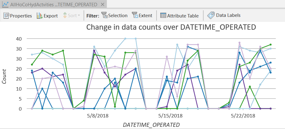

I have a dataset with recordings by date. For each weekend, I have zero recordings. The resultant line chart therefore drops down to zero each weekend. According to the Help Documentation here I should be configure a line chart to treat empty bins as zero (which I think it's doing) or to skip right over them by:
Interpolate neighboring values (Connect line)—Null values can be visually interpolated by connecting the line between the bins on either side of the empty bin.
How do I do this?

It looks like these options are only available if you use the Sum, Mean or Median aggregation options in the chart properties:
You could add a new field to your data and assign 1 to each feature. This can be used for Sum and would act in the same way as Count - although this might not be ideal if your data regularly changes.

Thanks Carmel Connolly‌ - to confirm if I chose to use 'Count' (which I want to do as I wish to see a count of submitted assessments per day) I don't have those Sum, Mean or Median aggregation options - see below. I did as you stated and added a new dummy numeric field, each containing a "1", and used that instead. However, yes, my data will be changing many times per hour and so this is not ideal at all. Can someone from the Arcgis Pro team offer a better solution?

I'm using Pro 2.3.3 also. Attached is a quick example of when switching to use COUNT the aggregation options disappear.

I see now what you mean. Yes, those options do not exist for Count.

The empty bins options are only available if the data is summarized (sum, mean, or median). When counting incidents, no incidents equal zero incidents, therefore those other options are not available.
May I ask what exactly you are trying to visualize? If you interpolate the line over the weekend, it would make the visualization appear as if there had been counts over the weekend, when in fact there were none.
