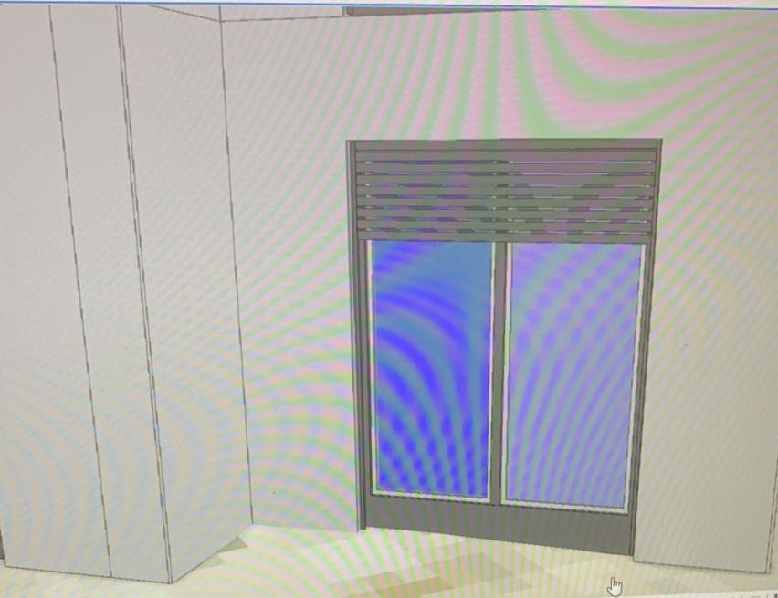

Hello, I am integrating a 3D Revit model into ArcGIS Pro for a GIS/BIM project. After importing the model, the ground floor foundation sinks below the ground surface although everything appears correct in Revit. Unfortunately, the elevation editing options are disabled in ArcGIS Pro, and I cannot adjust the model’s vertical positioning within the tool.can anyone help with this?

What tool are you using to adjust the elevation? My recommendation is to follow the workflow described here. https://www.esri.com/arcgis-blog/products/arcgis-pro/aec/geolocating-a-digital-model-revit-or-ifc-in...
