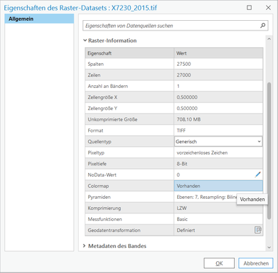

I found a solution.
I can set the nodata value of the image using arccatalog.

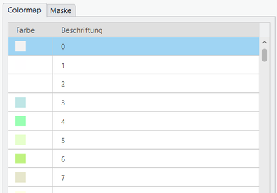

I don't get the RGB menu when I go to Symbology of the tif.  I see "Colormap" with no other choices.  Any suggestions?

Yes, normally you can select one color value as background color - but this does not work with colormap images. There is simply no menu to select this color.
I can export the colormap change the colors and reimport the colormap. But these are only rgb values. I can not change the transparency (alpha)

I found a solution.

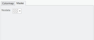

ArleneGuest1
I can set the NoData value of the raster, but that doesn't make it transparent.  Suggestions?
