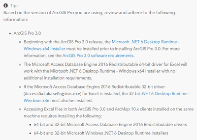

Finally, an issue that we've seen tripping up some users, is if the appropriate Excel driver (compatible with .NET 6) is missing. So if you have any Excel files in your maps, make sure to read https://pro.arcgis.com/en/pro-app/latest/help/data/excel/prepare-to-work-with-excel-in-arcgis-pro.ht... specifically the section about 3.0: https://pro.arcgis.com/en/pro-app/latest/help/data/excel/prepare-to-work-with-excel-in-arcgis-pro.ht...

@KoryKramer , I did these updates (particularly the Excel driver) and things worked. However, my Dell laptop did some huge BIOS update and then my Pro projects with an excel file started hanging again. I had to reinstall the Access Database Engine Driver and things started working again. I have no idea what my Dell BIOS update did, but it apparently removed that driver update. Anyways, just a little note for people who go through a Dell BIOS settings update, you may have to reinstall that driver!
