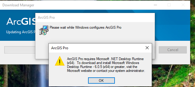

I haven't actually upgraded yet because I got the attached error when I tried to.  Going to have to get in touch with IT.
