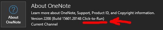

You can check the method by which your MS products were installed (Click-to-Run vs MSI) by opening up any of the MS apps, click the File pull down menu, then click Account and look for something like this....
If your MS products were installed using Click-to-Run then you must do a silent install of the Access DB driver. If your MS products are 32 bit then you must also do a silent install of the .NET Runtime.

1. I did not know of the 'decision tree' that was shown to me by Tim. So, I could not get the required Microsoft Access Database Engine 2016 files to install as described when upgrading, so I then had our IT support company install the Access DB 2016.exe for me. They got it installed and the ArcGIS Pro projects would open (those with and those without Excel files in them). I do not know if that means the files were installed silently or not. The Excel application on my machine indicates it was installed Click to Run.
