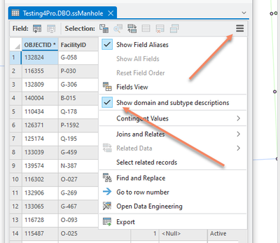

It's in the menu of the attribute table:
R_

Hello! The reply here provides useful information to turn off the decription (that is, to display the coded domain value without the description) for a singular table. I'm looking for a way to turn off the description by default (for all tables and all projects) like we were able to do in ArcMap as mentionned above. Anybody knows a way to get this done? Thank you very very much and have a good day!
Alex
