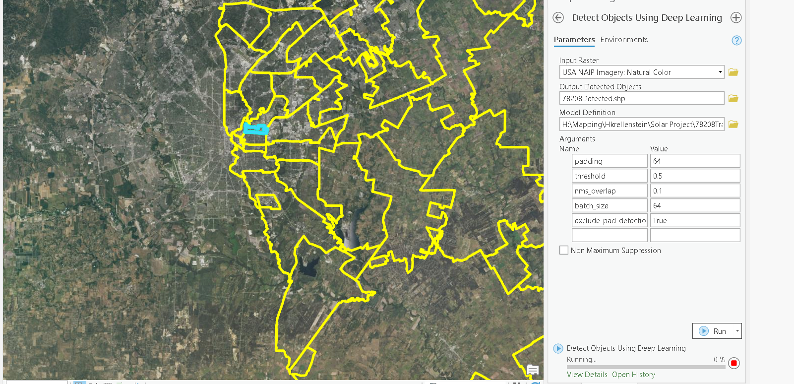

I am trying to run the Detect Objects Using Deep Learning tool to detect solar panels in NAIP imagery. I am using ArcGIS Pro 2.7, and I have selected one small zip code area to detect the objects. However, the tool has been running for over 15 hours and is still at 0% completed. My CPU is at almost 100%, so the tool is definitely running. Has anyone else had this problem or knows any solutions? Please help if you can!

Even though you have selected a zip code, the tool doesn't know that - it is trying to process the entire image. You have a couple of options: Clip out just the area you want to process and use that in the tool, or use the Extent settings in the Environments tab. The easiest option may be to zoom in to your required area and choose Current Display Extent.

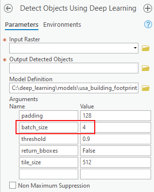

Using the CPU for deep learning will be really slow anyway. Do you have a dedicated graphics card (preferably NVidia)? If so, in the Environments tab you should set the Processor Type to GPU. You may also have to reduce the Batch Size parameter according to the amount of memory available on your graphics card as well (probably start at 4 and reduce if you get any out of memory errors).

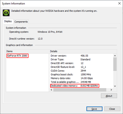

Pro will automatically drop back to using the CPU if the GPU is not detected. First find out your GPU model and memory - easiest way is in the Nvidia Control Panel. Click on the System Info in the lower left. Here's mine:
The important info is the card model and dedicated memory. The requirements section on the Esri Deep Learning Github site recommends minimum 2Gb dedicated memory (but you really need at least 4Gb to do anything serious). You also need CUDA Compute Capability 3.5 minimum, 6.1 or higher recommended. Find your GPU on the Nvidia CUDA GPU page and check your capabilities. Here's mine:

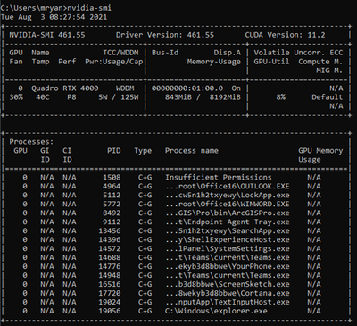

The tool ran for 42 minutes before showing this error. I have tried to ensure I am identifying the correct GPU in the Train Model tool - I thought I chose "1" correctly. However, when I check using nvidia-smi in Command Prompt, I get:
It appears here that the GPU is identified as "0".
How do I reconcile this apparent conflict? How do I ensure the NVIDIA GPU is being used most appropriately and efficiently? I am getting very slow performance in the Export Training Data tool (about 1% progress every hour) and am not sure my NVIDIA GPU is being used nearly enough - it's usage never goes above 11% or so. I need to know the correct GPU setting when I train my next model.
Thanks for any help
Tim_McGinnes
Not sure why nvidia-smi is showing 0 for everything. The Export Training Data tool doesn't use GPU, just the Train Model and Detect Objects\Classify Pixels etc.

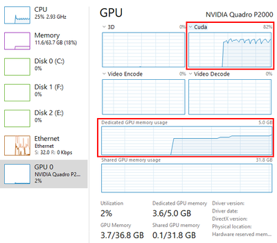

I generally just use Windows task manager to monitor in the Performance tab. You can set one of the graphs to show Cuda stats to see which GPU is being used. The dedicated memory is the other one - you can increase batch size to use more memory, which may make training faster (I don't know if this is actually the case or not).
