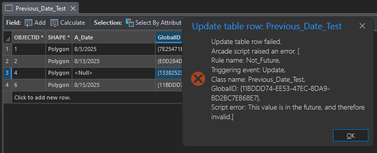

Here is a "Date" field called "A_Date" where I've entered a date in the past, today's date, left a NULL value, and then finally entered a date in the future (8/15/2025 at the time of writing this). This rule accepts the first three, and fails with a specific error message when a future date is entered.
This is sort of hack together "dynamic" domain, which seems like what you want. Using similar logic, I think you could also set something up where you only allow "yesterday," "today," or "tomorrow," that sort of dynamic date range scenario.
I believe there are time zone options available in Arcade too, if you want to go down that road.

Here's a very unnecessarily verbose version of this, but I use this basic template structure a lot for these "constraint" or domain type on-the-fly validation checks. You can incorporate several different checks and error messages, depending on what you're checking.
