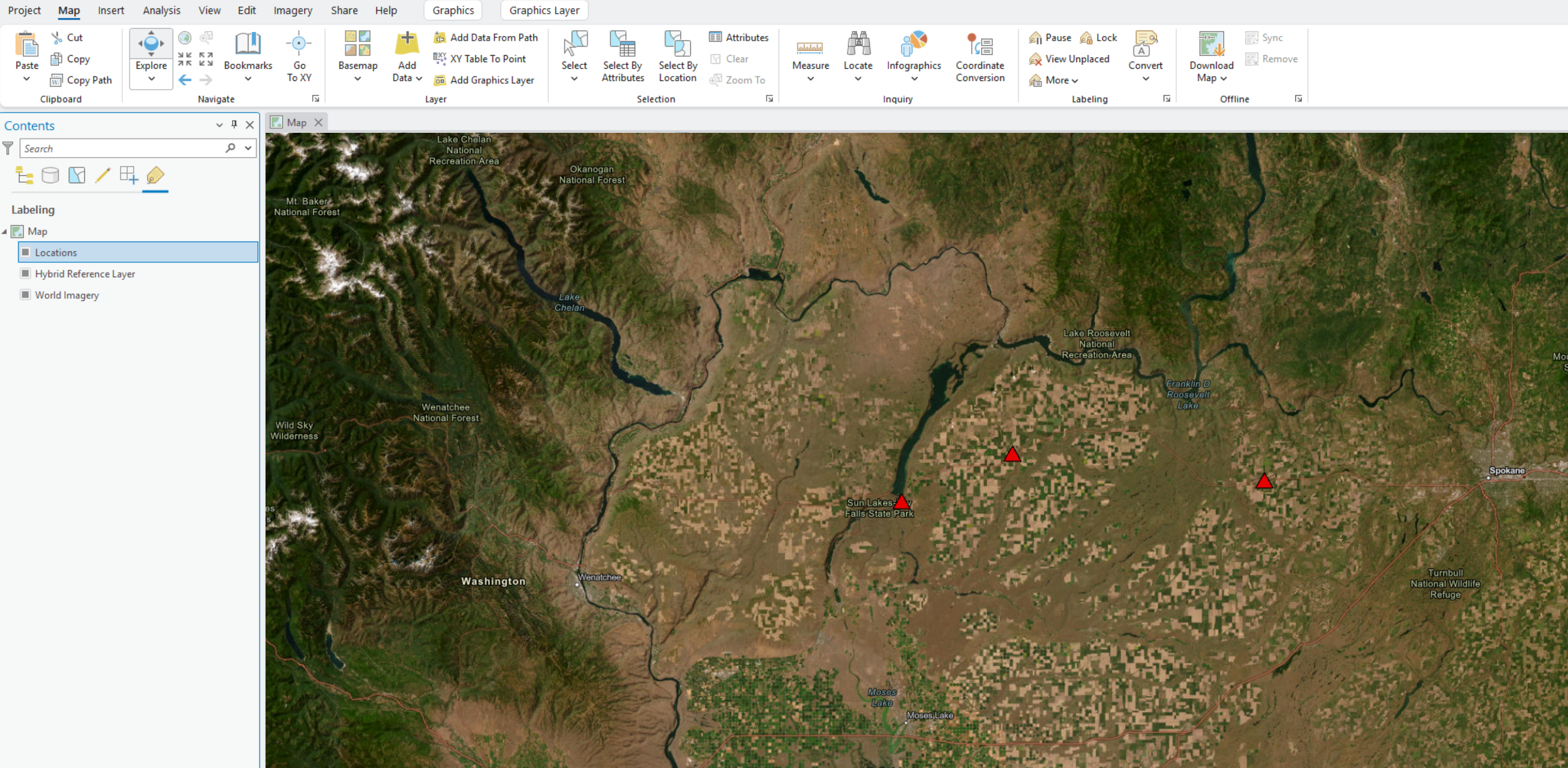

Just installed ArcGIS Pro Desktop version 3.5 and finding the learning curve extremely steep. I've been searching thru the online documents and videos, however, they either leave out critical details or are for older versions that don't match the screens I see in 3.5. I created a new map project and placed 3 locations on the map using WG 84 lat/long coordinates. I want to add labels to each of the locations. My locations are in a feature layer called Locations. According to what I've found here and elsewhere online, I should click the layer and then I should see a Feature Layer tab set with a Labeling tab but I'm not seeing that anywhere in the ribbon.  I'm sure I've missed something or skipped a step somewhere but I'm not able to determine what it is. Any suggestions?

Hi @Anonymous User, from the screenshot it looks like you are working with a graphics layer. So when you select this layer you do not receive the labeling tab as expected rather you see a graphics and graphics layer tab. the tabs you are referring to will appear when the source data is a feature class. Depending on the type of data you select you will receive a different tabs in your top ribbon.
try converting your graphics to a feature class

Thans for the links Brendan, that would seem to explain what I'm seeing (or not seeing 😉). Unfortunately, the link for converting graphics to features doesn't seem to contain any actual steps for completing that operation. There's a link hanging off that page referencing "Work with graphic elements in a map" that also seems to lack the detailed steps I need to convert the graphics layer to a feature set. I suspect I'll just have to start over on this project but not til after I've checked out the video link Robert provided below.  Thank you for the information though, I think you hit the nail on the head as to why I'm not seeing the ribbon options I'm looking for.

Unlike Arcmap which had the Graphics to Features command in the Graphics Toolbar, in Pro you need to use the Toolbox to accomplish this. Go to the Analysis Ribbon and click on Tools to open the toolbox. In the search bar, just type "graphics" and Graphics to Feature should be one of the results. Click it, select the graphics layer in the dropdown and then add the remaining parameters.
