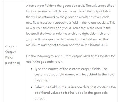

Customizations to the locator roles and the default output fields are not supported for the Create Locator tool.
 However, the Create Locator tool allows you to add up to 50 custom output fields that are returned in the geocode results. You could add the field names that you want returned like Streetname and assign the field from your data to the custom field that is listed in the Field Map section of the tool. In the locator properties Output fields page you can uncheck all of the fields you do not want returned in the output. When ArcGIS Pro 3.1 is released the Geocode Addresses tool will have an option that returns the minimal fields plus the custom user fields that were added when the locator was built. See step 9 in https://pro.arcgis.com/en/pro-app/latest/help/data/geocoding/create-a-locator.htm.

Thanks @ShanaBritt . That is exactly what I want. Thanks so much for providing this workaround. Actually I have already used the custom output fields in my locator. I don't realize that we can have up to 50 of them. That is really useful. I am looking forward to the Pro 3.1 which can remove some unnecessary output fields.
