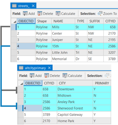

@MichaelVolz As far as the alternate name table I would create a StreetNameID field in the primary reference data and give each record/feature with the same street name the same ID, so if you have 10 'E Orange Lane' features they will get the same ID. Then in the alternate street name table you would have a StreetNameID field and record1 for 'E Orange La' would get the same ID as the 10 features in the  primary data layer. Then record2 for 'E Orange Lan' would get the same ID as the 10 features in the primary data layer. You data would have a Many (primary)-to-Many (alternate table) relationship and look similar to the image below.
The most common and I believe the USPS street types are already included in the geocoding rules and any abbreviation you have that is not working by default should go in the alternate name table. Then the Preferred Street Name settings in the locator properties you can specify which street name will be returned.
