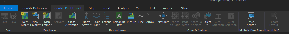

This is what it reverted back to:

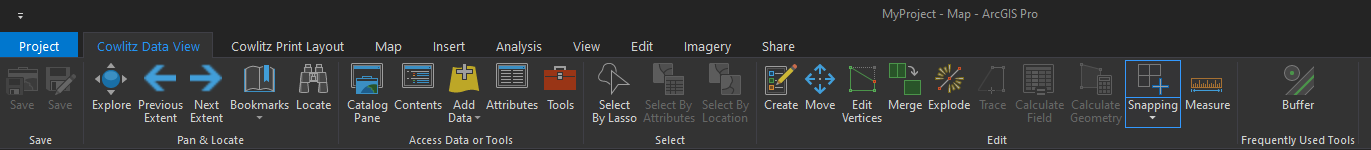

This is how it looked before the settings reverted back:

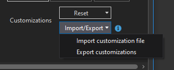

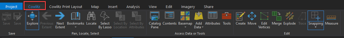

In the future, though, you can use that "Import/Export" button to save your customizations to a text file, which can be sent to different users and re-imported should you ever lose it again. It's also editable to some degree in a text editor, though few details are available as to how. I know that you can change the size of things from 'large' to 'small' and rearrange things easily enough.
Export option:
Custom tab w/ small icons:
Export option:

Thank you, I appreciate that. Everyone here is using ArcMap, so I want it to be easy for them to use ArcPro when we transition them over.
I exported the customization like you suggested so I will have it in case it breaks again.

Great! Your tabs do look very friendly for someone coming from ArcMap - I may steal them!
