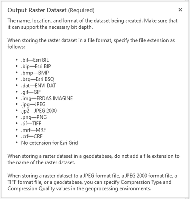

The output format of the clipped raster is determined by the extension of the output filename.
If you name it filename.tif, will create a tif file.
I prefer to create a polygon of the area that I want to clip, use that as my output extent, and select use input features for clipping geometry.

Yeah, I had named it properly.  The tool was still creating bunches of folders and files.  Maybe it was downloading the entire aerial first?  I'lll try again with a clipping polygon.

I read folders and files and figured that sounds like the GRID format.
Maybe those are temp files since 90+Gb sounds pretty big for "a small area".
