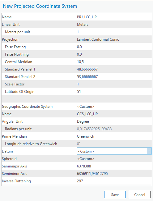

For educational purposes in an advanced GIS course, the students are handed a shapefile without a defined projection. The data itself has a Lambert Conformal Conic Projection based on a Hayford Potsdam datum which are both unknown to ArcGIS Pro.
The task is to create a custom projection and first apply it to the data per 'define projection'. Second, also a custom Transformation needs to be created.

1. Minor: Custom Datum and Spheroid are not nameable (should be 'D_HP' and 'Hayford_Potsdam'):

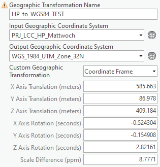

Now for the above custom projection a custom transformation to WGS84 has to be created:
When applying this created custom transformation some really weird stuff happens: I repeated the workflow several times:

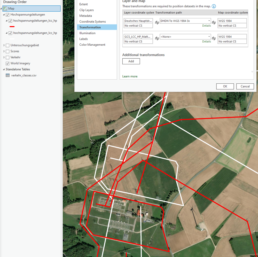

- Sometimes, the transformation is applied correctly and the layer is correctly located.
- Sometimes though, ArcGIS Pro seems to find a transformation procedure automatically without noticing the user and when applying the created custom transformation manually, the data has an offset.
This inconsistent behaviour may happen simultaneously within the same ArcGIS Pro Project.
Here some proof: The shape file (FYI powerlines/structures in germany) has been copied and loaded twice with the exact same PRJ:
1. No Transformation is applied but one shapefile (red) is transformed automatically anyway while the other copy (white) has an offset.
same copied shapefiles - no transformation appliedsame copied shapefiles - no transformation applied
2. Now the custom transformation is activated and now the red layer has an offset while the white twin is located correctly:
Same copied shapefiles - transformation appliedSame copied shapefiles - transformation applied
